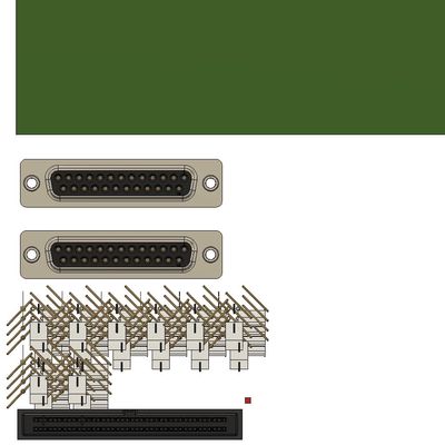

Although I have added 3d pictures of all components, after pushing my PCB board to fusion 360, it is as seen in the picture in fusion 360. None of the components are visible.

Here are a couple of images to better illustrate my experience...
Top component seems to be the culprit.  Notice how it is displace from the footprint, even though the library package seems to be lined up properly.
Removing that component allows the 3D packages to appear for the other components.
I will further examine the suspected device in my custom library to see if I can determine the cause.
Note that all of the components come from the same custom library.

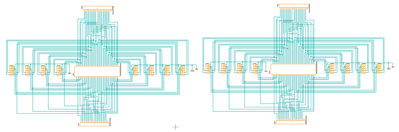

So last night and this morning I discovered yet another interesting aspect of the 3D package issue.  I added more parts to my Fusion 360 Electronics PCB design by copying the section that I already completed and pasting it into the existing schematic
I pushed the schematic to the 2D PCB and then to the 3D PCB.  This all worked pretty well, but the 3D packages for the added Jumper Switches were scrambled as shown here:
That was around midnight and I just didn't wan't to deal with it then.  I saved and closed the PCB design and quit Fusion 360.
This morning I fired up Fusion 360 and opened my PCB design with everything looking as I had left it last night. Feeling optimistic, I tried updating the library on the schematic page, pushed the schematic up to 2D, updated the library there then pushed to 3D.  Now the scrambled 3D packages are fine.
I should mention that immediately before I encountered this issue I had changed the footprints for all of the parts in the library contained in this design to increase the drill size of the pads.  As usual when I started up the design this morning I encountered a recurring issue with my custom library not showing all of the devices contained within.  That is another issue that I will document in a new thread and post in this thread later.
