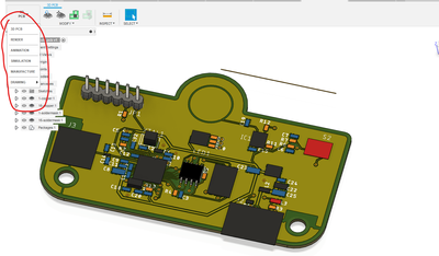

Hi I'm trying to add some packages for the PCB components but I don't find the model menu
also I don't have the replace option

The "Model" workspace is just for Fusion mechanical design. If you want to add new packages, please go to the 2D board workspace and add the parts, then create 3D PCB from it. It's not allowed to add packages in 3D PCB workspace because it breaks the associavity between the 2D and 3D board.
