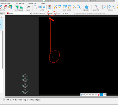

Pieter.Jan.Van.de.Maele
Hi all, one more thing I just wanted to add as a current-workaround is that you can use the "Mark" command in the command line to display coordinates relative to a selected point on the canvas.
"The MARK command allows you to define a point on the drawing area and display the coordinates of the mouse cursor relative to that point at the upper left corner of the screen (with a leading 'R' character). This command is useful especially when board dimensions or cutouts are to be defined. Entering MARK; turns the mark on or off."
This crudely allows you to measure things - note that it also displays polar coordinates for a distance/angle measurement:
No replace for sure for a measure command, but maybe something that gets you by until that time.

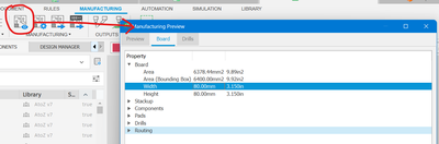

banksysan
A workaround could be the Manufacturing Preview.  The Board tab has board dimensions.
