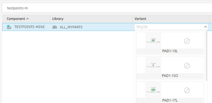

However, going back to the schematic, the component (testpoints-mine) shows up , but the renamed variation (ATP_20MIL) is nowhere to be seen.  I also closed down fusion  & tried again minutes later, no luck. Also tried update design from all libs as well.
typing in one of the other variants , shows up   WORKSnnovotney_4-1785488305493.png
typing in my renamed variant (ATP_20MIL) shows nothing (and as mentioned does not appear in the dropdown list)  FAILS
As another test, I right clicked a different variation TP127R and renamed it  FUSIONBARF & saved without making any edits at all.   It is also nowhere to be found in the schematic placer
WHY???????????  WHY???????????

It looks like this could be because you are renaming the footprint, not the variant.  Try using the panel on the right side of the component editor, that's where you see the variant names.
I'm still surprised it doesn't show up for the search - but I think what you are wanting to do here is rename the variant, not the footprint, which needs to be done on the panel on the right (variant panel) - right click one of the variants and hit rename.  Give that a try and let me know if it is behaving as expected.
This aspect of the content manager has been a point of confusion for people before, we are exploring better solutions.
