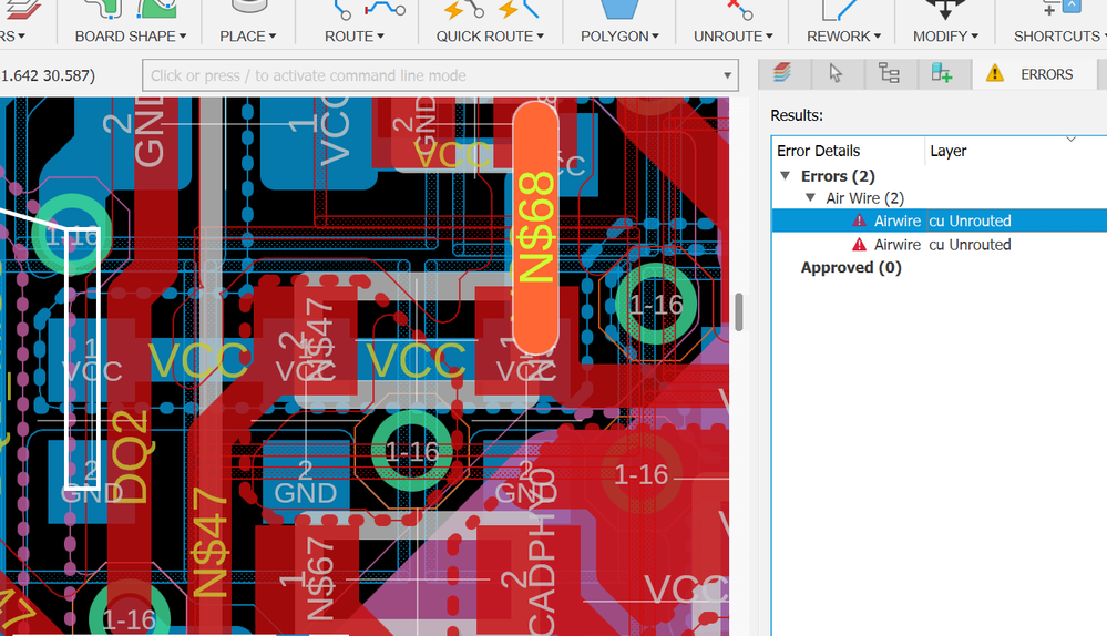

i have routed all the traces and airwire still some unrouted airwire errors are generated in drc check. i have tried checking all the the nearby traces and also tried to isolate that part by hiding layer but still there are no airwires there.
do anyone knows about this issue ?

I hope you're doing well. If you can post and image of what you are seeing this will help. By chance do you have any components rotated at a 45 degree angle? You might have some really short point airwires that are difficult to see. Sometimes just running the autorouter will take care of it.

See in both of screenshots none of trace are visibile still unrouted error is there please help me out with this
isalabhi9999
update:-i have soughted the issue with the first error i.e first screenshot.
the second one is still an issue

Let's make sure you don't have any airwires hidden. In the Electronics CLI please type
RATSNEST *
and press the enter key. If you have any hidden airwires they should popup.
The second image airwire might come from a gap or island formed when the polygon is filled. Try filling in the polygons and check for the airwire again.
