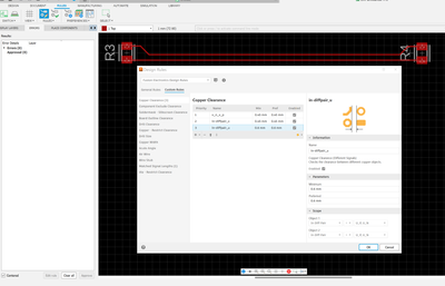

The custom rule doesn't work when routing differential pairs.

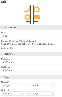

I'm trying to set the space of differential pair B0_P and B0_N and add a custom rule as below
The general rule was kept as below
After trying different scopes in custom rules, nothing affect the space of differential pair.
where the grid is 1mm, wire width is 0.254mm.
It only shows the violation of space, but the space parameter still follows general rule but not custom rule.
Please help to clarify if I'm missing any setting or how to control the space of differential pairs.

Hello @aiolus2ZLRU,
I hope you're doing well. Thanks for reporting this, we ran into this shortly before release the developers are already working on this one.
You are not doing anything wrong it's just not working right now. I'm hopeful that by the next release this will be sorted, can't promise it but I have a good feeling about it.

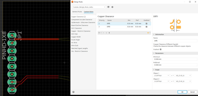

I have played with the diff-pair router and the custom rules and you can use In Net Classes scope if you have a net-class that contains your diff-pair or all of your diff-pairs for both Object 1 and Object 2 or you can use In Diff Pair scope for both objects. Using In Signal will not work at this time because the quick-route diff-pair engine only uses one signal to get the clearance and the custom rules require 2 scopes (we can't use the same signal on both Object 1 and Object 2 scopes). I am looking into improving this behaviour right now. If you can use any of the above scopes that would help you circumvent this issue. Please see the custom design rules snapshot bellow:

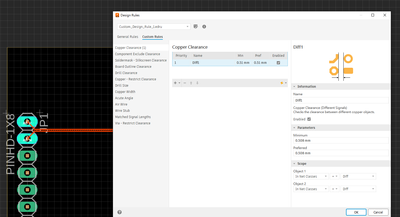

I reopen a test project to try the differential pair routing on my desktop. I reload default design rule and add only 1 custom rule for clearance which resualt as below:
Space didn't change, only violation was showed.

Sure, I've tried In Netclass Scope but not work on my desktop as below.
it's really weird, I'll try again on my laptop.

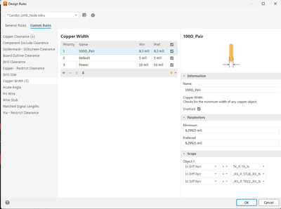

I am seemingly having the same issue.
Custom rule for width of the differential pair traces:
Custom rule for spacing of the differential pair traces (I tried both same signal and different signal versions):
The differential pairs are routed with 5 mil spacing instead of 6.7 mil spacing, as if the custom rule is overwritten by the global default spacing rule:
Thanks in advance for all the support!

The problem here is that the rules are mis-scoped. Every scope is composed of AND so what you are saying is if an object is in the DIFFpair TX_P, TX_N AND DIFFpair STUBRX_P, STUBRX_N ,etc. There's no way an object will be part of both the TX Pair and the STUBRX pair at the same time so your rules are effectively doing nothing.
The better approach would be to scope to a netclass. Try making a netclass and assigning all of your diff pairs to it. Now scope to the netclass
Give that a try and let me know if you continue to run into problems.

Thank you Jorge! Assigning the nets to a net class and defining the copper width and spacing for that net class solved the issue.
