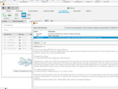

You could leverage an ulp to import the dxf file. Open any existing board or create a new board and then save(File being saved is necessary here)->turn to automate tab, start ulp-> select import dxf to import geometries to the layer you want to locate on.
Hope that help
-Yiqiu
andy2JEYH
This solution worked perfectly.   Thanks
