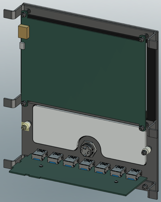

I'm trying the new 'Derive PCB from Sketck' tool to create a PCB outline based on Design view geometry, but I can't find a way to do it without the derived PCB being 'upside-down'.

For context, the board goes at the back of a panel, shown here (you might be able to make out the construction plane on the left of the white standoffs):

I also struggled with this "feature". In my case, I found that rotating the view of the sketch image 180 degrees in the viewer (curved arrows next to the house) and then performing the derive steps was enough to generate a PCB with the correct orientation. This was surprisingly painless after wrestling with it for half an hour, but I have not experimented further with it to establish why this works - it really shouldn't adjust any origins. In any case, hopefully it can help someone else with the same problem...

Hi @DavidVoxon@craig.scott575DB , et al. previously we simply use the sketch coordinate system to create the PCB. In the next update, we will release the feature to let you define your own coordinate system. So stay tuned.

Today we release Fusion 360 V2.0.12157.
Now we can select the Origin and X Axis when create PCB.
In this way, you can correct the PCB you want more easily.
Please have a try, thanks!
