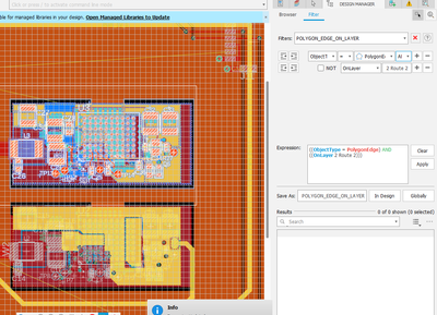

If I select an area of my PCB and then go to the Filter section I cannot get it to show the objects like you discuss.
I attach a screen shot.   Is there some other thing that must be checked or something?
mjstn2011
New insight.  If I KISS and just say show polygon edges in selection filter I get all edges on entire board (like over 50).
If I add   besides PolygonEdge for just layer 2 then I get nothing.  Perhaps I must say 'layer 2' in some very precise way?   I have tried adding 'OnLayer' and   '2' and some other names for layer 2.   If I state polygon edge AND a layer nothing shows.
Furthermore if I say PolyGon edge even if I have formed selection rectangle over area of the polygons I want to modify the lower right seems to show ALL polygon edges in the entire board  (outside of my selection box).
I hope I have stated this well.   Thanks for any thoughts on this.   Mark

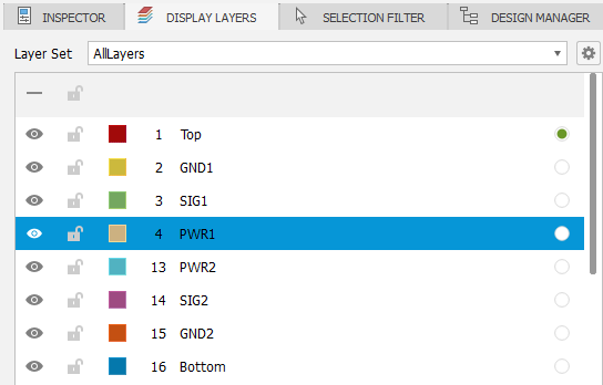

chuck_toddN7PTC
@mjstn2011
It seems that you have to put the name of the layer and NOT the number.
In my opinion, it should probably work with both. (Layer Number and Name)
See my example below:
BR -Chuck
Chuck
mjstn2011
Thanks @chuck_toddN7PTC   that was the problem.
