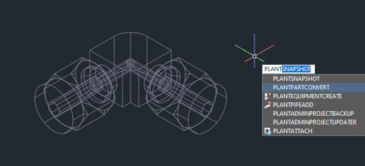

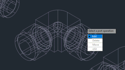

  1. Import the STEP models into a drawing session.  Explode them and recreate blocks for each size.  I recommend to use the part number.  (For example SS-810-9 for 1/2" union elbow)
  2. Change to wireframe (it is easier to see and select the ports)
  3. Run PLANTPARTCONVERT.  Select the block. Follow the prompts to select each port and it's direction. Clicking Accept each time.  When all ports are selected click Exit.
  4. Save the drawing session as for example SwagelokCatalog.dwg

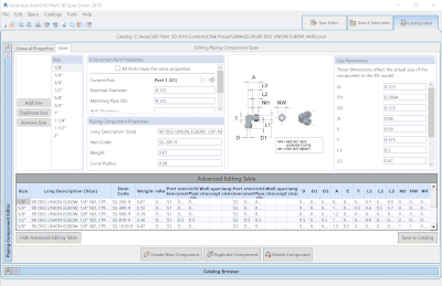

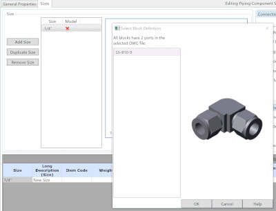

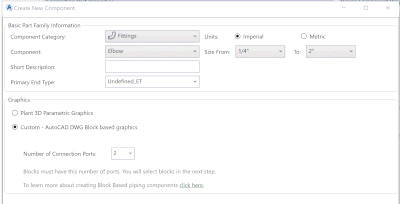

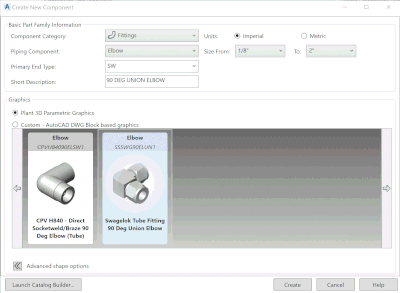

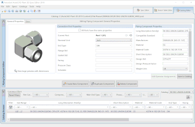

  5. Start Spec Editor.  In your Swagelok catalog Create New Component using Custom - AutoCAD DWG Block based graphics.  For each new size created Select Model... and browse to the SwagelokCatalog.dwg and select the appropriate block. Click OK.  Fill in all other required field as you normally would.

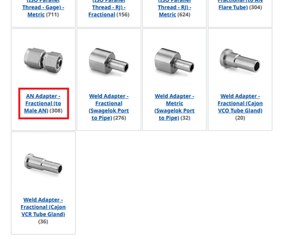

Yes, 308. All of one category of items;
That's not a lot of items, compared to some of the categories. For example, the one below has 1316 items within this single category;
And that's still not the maximum number per category. You can download a maximum of 500 CAD files in one request. So 500 is the size constraint.
If I make smaller requests, it would take forever to download their entire CAD catalogue.
