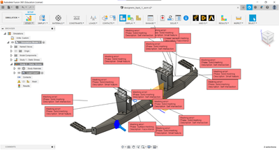

hello Everyone!
I was working on the static structural analysis study for an assembly consist of multiple parts and while meshing i encountered errors such as small feature,self intersection and face interior. Some of the parts which weren't involved so i tried to suppress them by hiding but i guess hiding doesnt suppress it.please help me to find a way to refine my geometry.

Hi @PRATEEK.YASH2019
Thanks for the post. You're correct, turning off the visibility of components, do not exclude them from a Simulation Study. Instead, the components will need to be removed from the Study. Here is a link to a video that I created that shows how to remove components from a Simulation Study
Let me know if this answers your question.
