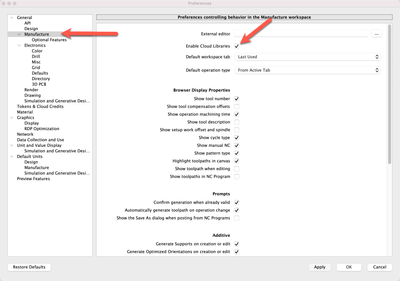

I am struggling with my students being able to upload a library of tools I have created for them to use. For most, they upload the library when they are creating a machine path and select the tool they wish to use, when they next open the design there is only that tool in the list of tools available, the rest have disappeared and they have to upload again. On my account the tools are always there. I wondered if there is a setting in school that is refreshing the local folder or is it the fact they might be working on different laptops? Is there a way for me or the IT tech to link to a tool library automatically?
On one student the library is listed but there are no tools - no idea what is going wrong here!

Hi @Andy_Marston I think I can help clear things up. Tools can either live in a document, or they can come from a tool library. If tools are created or copied to a document (the part you are programming), then those tools are only available in that document.
You will see that there are two possible tool library locations. You can store tools in a local tool library, or a cloud tool library. Note that the cloud tool library isn't on by default and you have to enable that option before the cloud library location will be available as shown in this screenshot.
Typically a user will create a tool library. Then when programming, select the tools from the tool library. When the tool is selected, it is copied to the active document. Instead of your students coping the tool library to their part, I recommend they create a cloud library, or a local library where the tools are stored and can be accessed for any future parts.
You can also create a Team cloud library so that any member of the team has access to the library and you don't have to email the tool libraries to each student.

@Andy_Marston If you turn on cloud libraries and your Team members (students) turn on cloud libraries, you should all see the same cloud libraries. Just note, currently, folder permissions can't be placed on the assets folder (where cloud libraries are stored). So you will want to keep back ups of your tool libraries in case any students modify the cloud tool libary instead of editing the libary for an operation.

Just to verify, they have enabled use cloud libraires in preferences, correct?
