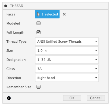

Hi all,
I would like to make a C-mount adaptor for my lens.
And I know a thread spec of C-mount is 1'-32.
But, I can't find the thread type that I can edit. which function should I use to solve this?
Thank you 🙂
762 Views
o.briggs
Hi @kyoungikCGQCQ
I believe 1"-32 is an ANSI thead type. You should be able to find it within the ANSI Unified Threads type.
Please let us know if this isn't the thread you are looking for 🙂

kyoungikCGQCQ
Great! Thank you !
