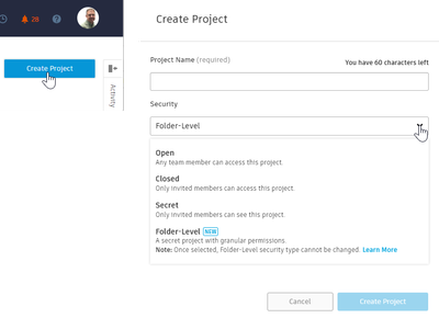

The different icon indicates that these are "Folder-level" projects. But now I seem to only be able to create "Folder-level" projects. So all new project names will be visible to my whole class? (But they at least can not see the contents).

Thanks for posting your question and the kind words. I'll share your feedback with the Fusion Data Team. If needed, you can still create legacy project through Fusion Team. A couple thoughts about your project visibility question.
  1. I looked and at your Fusion Team and each students' Role appears to be set to Project Contributor (this is the default and looks correct).
  2. I can see that many of your legacy Projects Type is set to "Closed" = Only invited members can access this project, but members in your Fusion Team will see the project in the Data Panel and can request access.
    1. I'd suggest changing the legacy Projects Type to "Secret" = Only invited members can see this project.
To change the legacy Project's Type to Secret, please do the following.
  1. Navigate to your Fusion Team https://login.autodesk360.com and sign in using your Autodesk ID.
  2. On the left column, click on a legacy project.
  3. On the far-right, in the Project Details section, click on left facing arrow.
  4. The Project Type will be displayed.
  5. To change the Project Type click on the gear icon.
  6. In the Project Settings dialog box, change the Project Type to "Secret"
  7. Click on the Save button.
  8. Repeat for your other legacy projects.
Please let me know if this helps.

If desired, you can create legacy project types through Fusion Team.
  1. Navigate to your Fusion Team.
  2. On the top-right corner of the screen click on Create Project.
  3. In the Create Project dialog box, enter a name of the new project and then set its Security Type.
Hope this helps.
