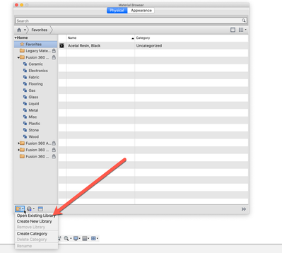

Here is how you can use that library you downloaded in Fusion.
From the Modify Menu select Manage Materials
Then Click this icon and Choose Open Library and browse to your library to open that file.
If this is what you are looking for, please mark this answer as the solution. If not, let me know what didn't go right.
