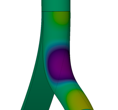

Today I've done some practice modelling on a Y-transition after I saw this thread. The model turned out just fine, though I do have a few questions on things I noticed during an earlier stage of the model. When I turned on lock stripes in Zebra analysis it created some artifacts, is this just a projection issue of the texture?

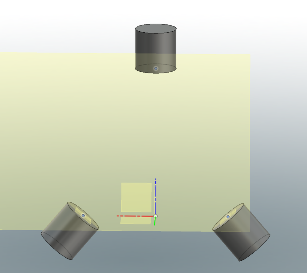

Second, my construction lines for tangency constraints in the sketch did not maintain their connection with intersected geometry points. Is this generally a bad workflow? See the video and I've attached the file just in case.

That is just an artifact of the lock stripes function.

Also, the spline constraints work. However, the construction lines don't seem to update with changes in the geometry. How were those created ?
Intuos5
@TrippyLightingThe construction lines were created by intersecting the 'horizon bodies' with a plane through their construction circles' midpoints. I then intersected the bodies with this plane, but instead of choosing the sides, I intersected the top/bottom and connected the endpoints with sketch lines. These do not hold position with a change in parameters. However, now that I've just intersected the sides, they do.

Since the surface part in the center wouldn't join properly, I redid it with surface modeling instead, it's much faster in computation, you're right as usual. Note that I used the constraints I used for my own testing purposes in this case. 😉
It only self intersects when I change the angle of the ends due to this particular spline handle, but I consider it done anyways.
