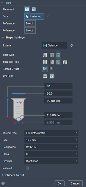

Hello, fusion is giving me the wrong drill size for M10, should be 8.5. Anyone else having this problem?

Here's what mine shows with the same selections:

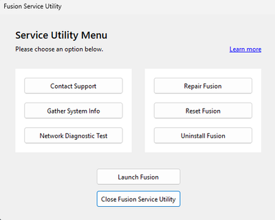

Maybe try to reinstall, or at least repair install via Service Utility?
Are you on the latest version?
maartenF74UH
That did the trick! Thanks
