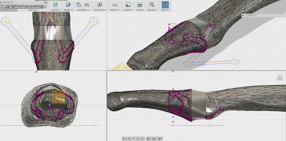

    Thanks for the response =). I've attached the .F3D file in case you feel like having a tinker with the file. I was trying to avoid variations that required splitting the object into a front and a back as I know the wrapping object will extend past half way so I would clip the wrapping (as far as I can tell). The Cylinder was just a simplified example. The more complex example I'm working with is more organic in nature (bone).
    You can see I also had another problem in that the wrapping shape was disappearing between the two bones so I had to make a loft between them from nearby perpendicular cross-sections and then fusing the whole thing together. The wrap around polyline looks better than it started only because I started manually deleting the duplication at which point I figured my time was better spend hunting for some people smarter in this program than I =).
    If you come up with a nice process I'd love to hear it =).

The file you sent is just the cylinder. I wonder if it might be worth it to get a cylinder from the sculpt environment, try to wrap the M to it and extrude, and then use the pull function in Sculpt to make it conform to the shape of the bone.
Otherwise I think @TrippyLighting is absolutely right. What you are trying to achieve would be done in UV mapping with a displacement texture
