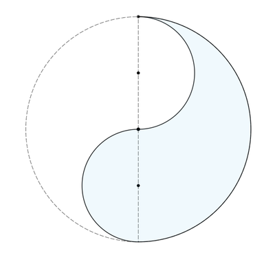

So recently I had the fun idea of making a YingYang inspired project but as a Ball to place down on the desk for example. However upon making the rough design, I noticed something fairly ugly.

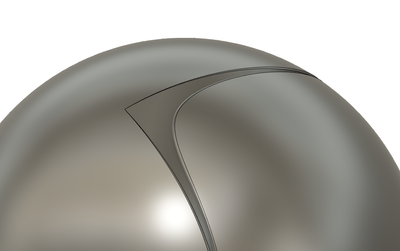

This ball looked fine from the front, but once you turned upwards...
You can see that where a half cuts off, it leaves a weird seam, which doesn't want to round over at all.

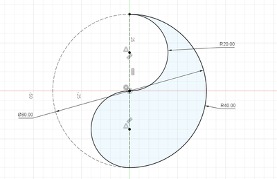

I've tried to trick the system to allow me to make it at least look fairly round, but ended up not finding an answer on my own.
So I wonder if someone here can help me make this YingYang ball with a rounded over seam to fit the other 'fang' edge which btw has a 0.5 fillet on it because the sharp edge point (fang) would be impossible to later print.

That "weird seam" is the logical result of your splitting action.
You'll have to re-think and change your approach to model this.
Perfect half circles will not work.
