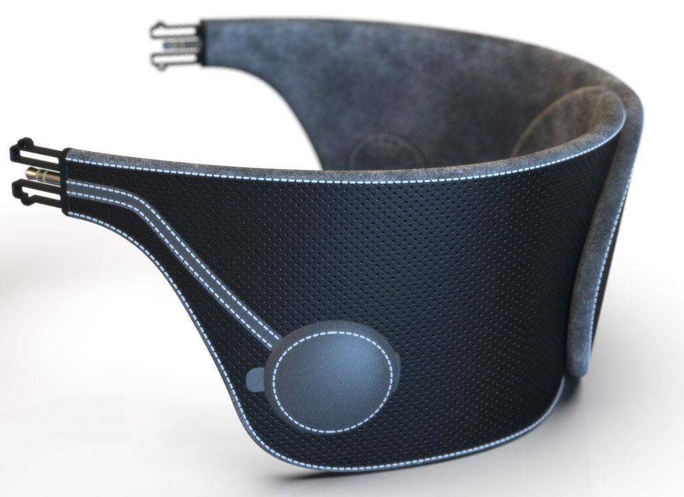

  1. No space modificators (bend, twist, tapper, flow along curve etc)! It is really a stumbling block. I am speaking about flow along curve in Rhino with use of which I can bend a complex model (assembly) into the exact shape I want. I can deform it with highest precision and it is a routine workflow - make a flat complex model, bend it with flow along curve. Or simple bend modificator where you bend the model interactively. Please check few examples - the googles head strap - made flat, then bent into needed shapes. Takes just a few minutes to bend the entire assembly. Or the watch strap (not a simple extrusion, it is curved in 3 dimensions. Really hard to make it in curved state at once. Furthermore, I need flat strap and different variations of its curved state, as well as the googles head strap. It is too complex to make it bent at once, and if you need it straightened out it is a problem, need to have both models. What we have in some tutorials about bend in fusion is absolutely different, it is very simple example where you bend the surface, thicken it etc. Will not work out for 180 degrease bends (will not be able to intersect it as it should), cannot make further modifications with ease, so it is not a way out at all. Maybe someone knows better workflow for such situations?

Flat straps are bent with "flow along curve" modificatorsFlat straps are bent with "flow along curve" modificatorsBent entire assemblyBent entire assemblyComplex chain pattern bent into a fastened stateComplex chain pattern bent into a fastened stateStrap with 3D edges bent into the twisted shapeStrap with 3D edges bent into the twisted shape
