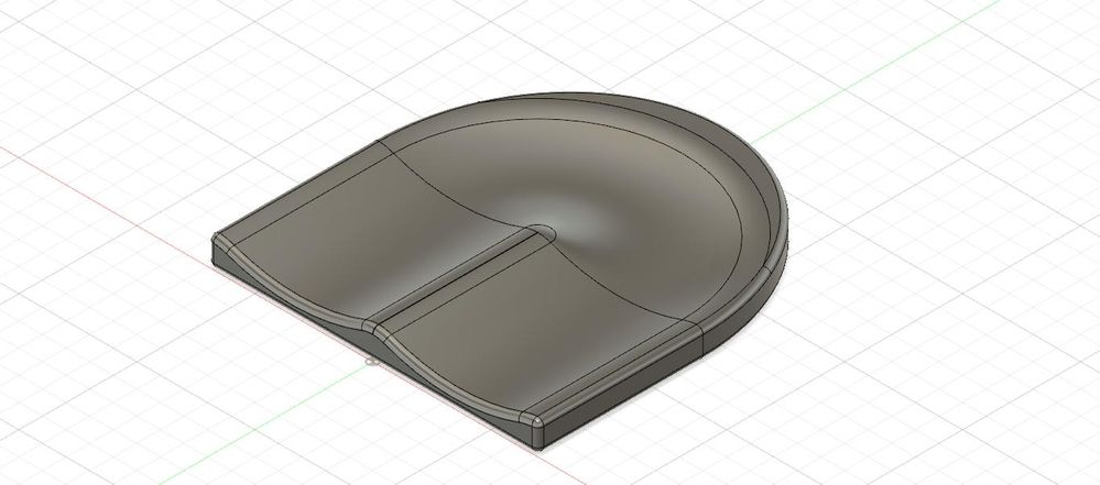

I am looking for suggestions on modeling a chair scoop.  I have played around with sculpt but my workflow isn't very good. attached is my file but it is not that good.

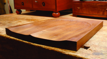

this is what I am after
any pointers are appreciated.

Sure. Here's what it looks like rendered (not in Fusion though).
Here's a screenshot of a seat pan of a rocking chair. The edge flow of your model in sculpt mode will be very similar.
.f3d is attached for closer observation of edge loops, preferably actually in box mode.

@TrippyLighting so how do you go about roughing in the shape?  do you start with a box, plate, sketch?

Here is my go at it. I sketched the profile and then extruded for the body. Then created an offset plane for the "sculpting" profile and used Revolve to remove the rear curved section, and sweep to remove the two straight sections. Last I filleted the remaining sharp edges.
I tried to use a single Sweep but it wouldn't work because the profile couldn't follow the neccesary path without cutting into itself and generating an error message.

I modeled and rendered the entire chair in Blender/Indigo Renderer a few years ago and the seat I posted was part of that model.

@Anonymous I had a Model attached to post # 4. You need to move out of the solid modeling workspace to create such models.
This was modeled initial in a Sub-D application (Blender) as a quad-mesh and then imported and converted to a T-Spline.
However, would also a nice object for modeling with surfaces in the Patch workspace.
