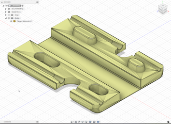

I paid a full license pretty much solely to be able to use prismatic conversion of stl files.  I don't think I have ever been able to convert a single one successfully so far (20+ different models).  Watched tons of videos.  What am I missing?
  1. I place, center and set units of measures on stl file
  2. I Generate Face groups (fast or accurate - tried both)
  3. Convert Mesh, prismatic, and... fails.  Either completely, or I get a weird model.
I mean I get the point that it's it's a cube, it will work, but that's something I can re-make.  I am kind of expecting it to work on complex models - otherwise what's the point?  Or am I doing it wrong?
Original STL
Fast / Accurate Face Groups
Failed result (fast / accurate)
I've attached the stl model.  A
Any help is appreciated.  Thanks.

I will answer myself as I got it to work....  When converting to face groups, using accurate, I change the precision to 10x less.  From 0.001 mm  to 0.01 mm.  It worked.
Edit: at 0.01mm, it still didn't generate a body.  There were "holes" left.  So I tried the face groups again with an accuracy of 0.005 and miracle.  I have a workable body.  Thanks.
