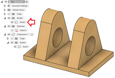

Here is what I start with:
When I combine this as follows:
I get a new component as expected, but a body gets left behind as well. This happens to be the original target body selected in the Combine GUI options:
Now my question is, why does this happen? I can't delete that original body since I get a message that "deletion causes downstream feature failure". Why?

Because you ticked new component.  Untick the option, you will get what you expect.
Body 3 belongs to a top level sketch.
Might help….

What I mean is, when I click new component, all the bodies should be combined into an actual new component and a copy should not be left behind.

That's just the way it works.  If you want to get rid of the old body, use Remove to do that.
