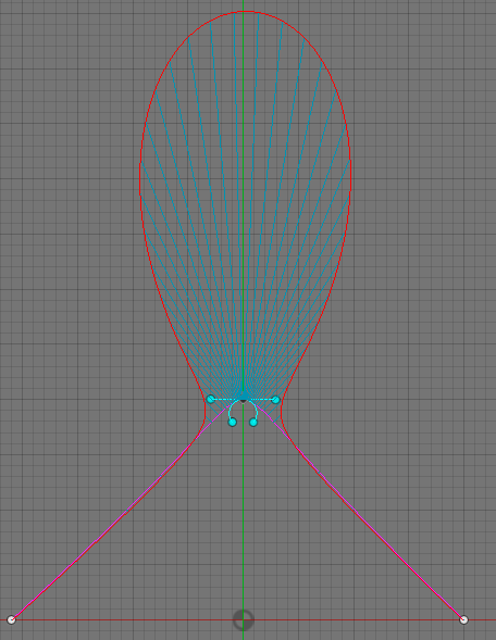

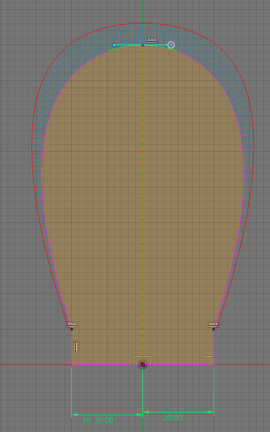

cekuhnen
@jeff_strater
So that the changes to the spline translate to changes across the complete spline makes sense.
I am still struggling where the G2 handle could be useful for "on" a spline.
The tangent one can produce a nice and smooth arc around a center fit point where with the G2 handle
I can change it to a way that the curvature is crazy.
Screen Shot 2016-08-09 at 4.32.20 PM.pngScreen Shot 2016-08-09 at 4.31.56 PM.png
I know that with making the G2 handle very tine I even bend the spline inwards
Most times I use the G2 constraint when making a blend curve which seems to be the most common application
while there the G2 handle is disabled for the blend curve - only the G1 handle can be activated.
Also the handle bug is still present:

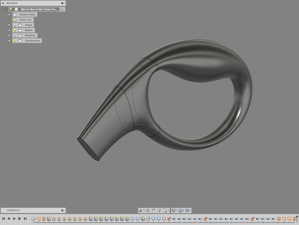

cekuhnen
@jeff_strater
Don't misunderstand me actually. In certain situations spline is a much nicer tool than CV.
I see the spline a piece of plastic that wants to destress and I think your way of explaining it follows a similar logic.
For smooth shapes like this (espresso damper) it is ideal and much nicer than in Alias - also the workflow in Fusion is better.
Screen Shot 2016-08-09 at 7.59.42 PM.pngScreen Shot 2016-08-09 at 8.00.23 PM.pngScreen Shot 2016-08-09 at 8.02.51 PM.pngScreen Shot 2016-08-09 at 8.08.57 PM.png
In Alias I could also work with a degree 3 but it seems I have less the smoothness of the spline specifically the tip in Fusion is pleasing.
Claas Kuhnen
Faculty Industrial Design – Wayne State Universit
Chair Interior Design – Wayne State University
Owner studioKuhnen – product : interface : design
Message 7 of 8
cekuhnen
@jeff_strater
I just finish another old model just now new in Fusion and it is a very organic shape.
For sure getting this smooth and even with a nice curvature comb is D like DRAMATICALLY easier than in Alias with multiple curves
For this type of a model the splines are actually ideal !!! You always end up with good graphs a lot faster than all that CV pushing with a CV curve for something like this.
Screen Shot 2016-08-12 at 10.04.49 AM.pngScreen Shot 2016-08-11 at 11.27.30 AM.png

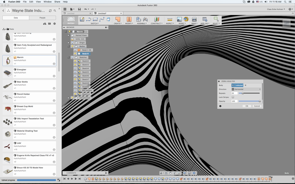

cekuhnen
@jeff_strater
Here is a finished version but unfortunately the Patch tool does not really deliver accurate G1 or G2 surfaces as one can see the break in the zebra and shaded highlight.
Screen Shot 2016-08-12 at 11.19.40 AM.pngScreen Shot 2016-08-12 at 11.16.22 AM.pngScreen Shot 2016-08-12 at 11.22.31 AM.png
