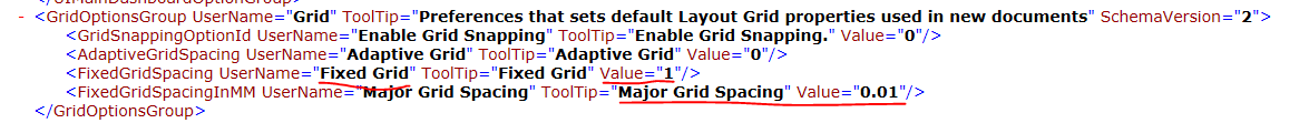

We looked into the Diagnostic Log Files. From the option file, the grid spacing was set to a very tiny value (0.01mm) somehow. The grid is too dense, therefore, looks like a black box.
The options file is under: \Neutron Platform\Options\[AccountName]\NGlobalOptions.xml
The corresponding UI dialog could be:
The default grid setting is Adaptive. It explains why resetting option works for your case.
