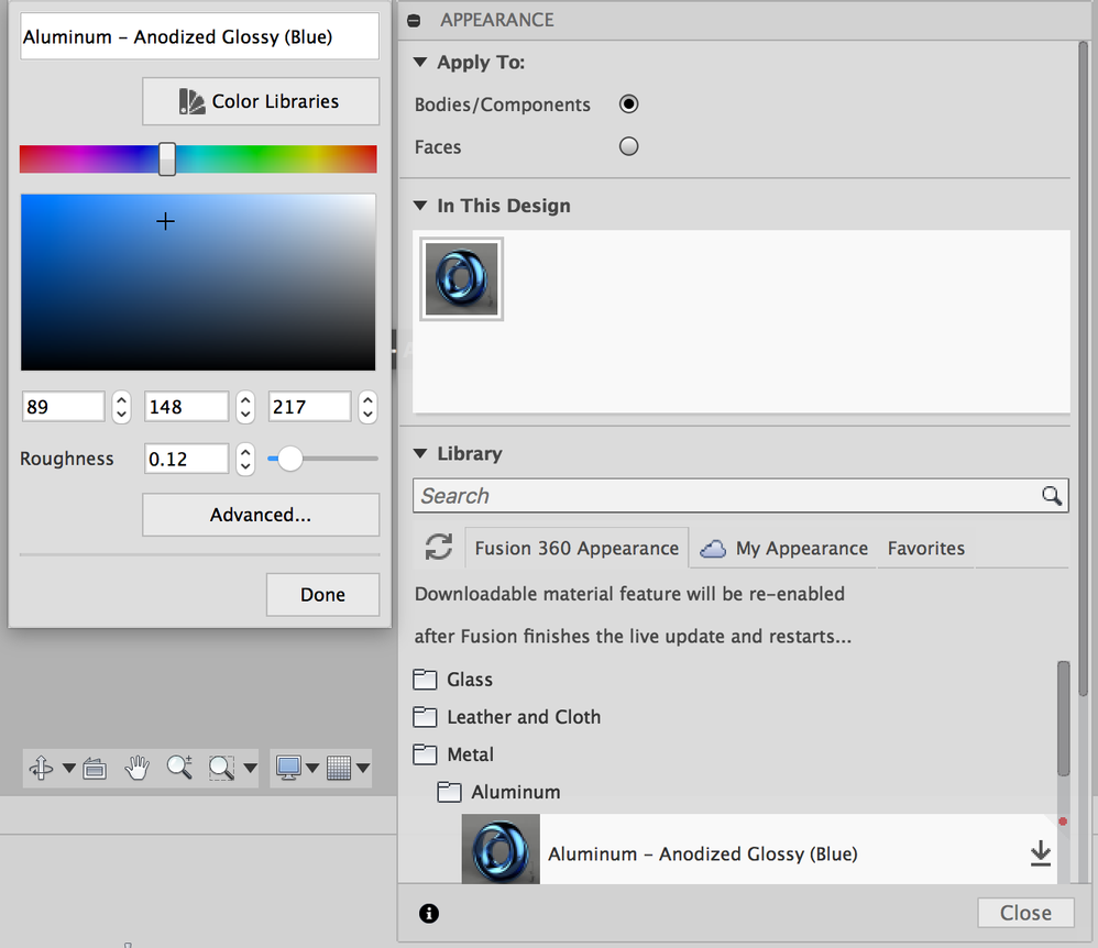

Hi @Anonymous
All material and color information is stored in the Appearance Library.
If you modify a library material and want to save it you can right click on the material swatch and select Copy To My Appearance.
The items in My Appearance items will follow your account.
Hope that helps.
