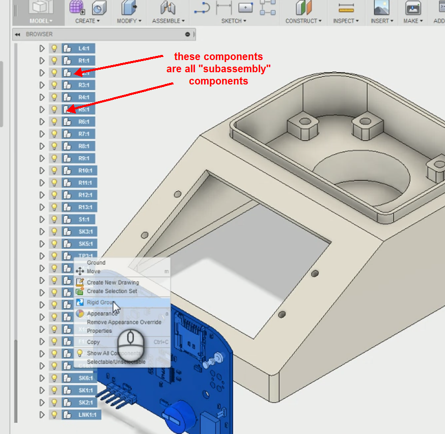

I'm trying to insert an STL assembly created in Altium PCB and joint it with another component.  When the subassembly is aligned at the joint only the first component, the PCB, is moved into place.  I've tried creating a rigid group of the compoents in the subassembly but it has not effect.  What am I doing wrong?

The issue here is a Rigid Group issue.  The way any constraint (Joints, Rigid Group) work in Fusion is only at the leaf-level components (those with no children, or "parts" to use another term).  However, when you select components in the browser, you are only getting these "sub-assembly" components.  So, any components below those will not be constrained.
The way to make this work as you expect is to start the Rigid Group command with nothing selected, then use window select to select the components.  That will select components, all the way down to the part level.

A couple of commentts though.  Once I selected rigid group from the assembly menu I could not use the window select.  However, I got it to work by reversing the sequence, window select the baord and then select Rigid group.  Also what is paticularly confusing is that the Rigid Group Dialog box has a tick box for child components.
Message 6 of 10
jeff_strater
Agreed - that checkbox for child components is supposed to do what you think it does.  This is a bug, and we will work on fixing it.

Good news.  I don't know for sure when this will be released (I think later in July, but don't hold me to that), but here is a preview from the current dev build:
