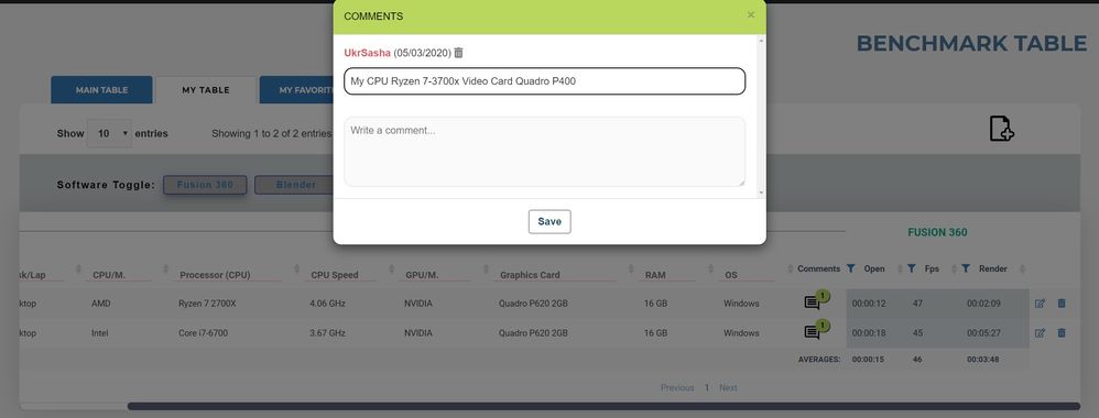

Hi everybody.
I have Ryzen-3700x at home, and i7-8700 at work.
According to my feelings, the 8700 is faster.
But I can check your test.
Message 17 of 86
Beyondforce
Did you check out tesreg.com?
Ben Korez
Fusion 360 NewbiesPlus
Fusion 360 Hardware Benchmark
| YouTube
Message 18 of 86
Yes.
Tomorrow at work I will do the 8700th test.
Message 19 of 86
I checked the performance of the i7-8700 at work.
It turned out that it renders more slowly than the 3700x.
In the photo, the processor is 2700x. It’s just that my 3700x was not on the list.
Message 20 of 86
Beyondforce
Do you have the 3700x?
