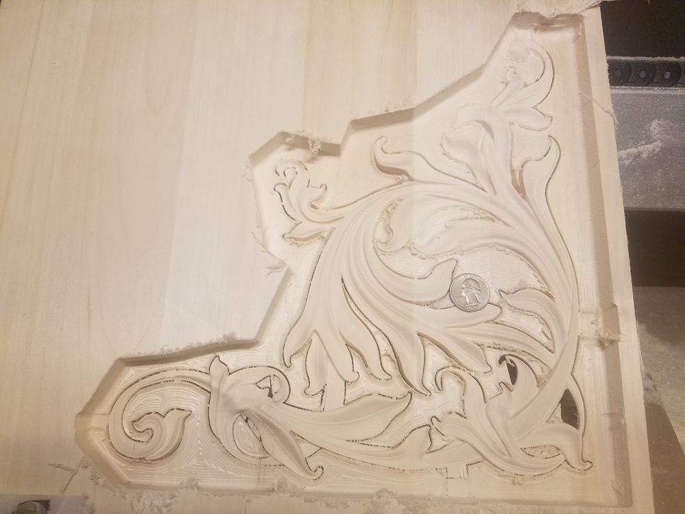

You have to look really close to see any tooling lines. I made a few mistakes so I'm going to mill another one tomorrow.
A lot of what you see is actually just dust...all I did was pull it right off the mill and snapped some pics.

TrippyLighting
Stunning! The design and the execution.
But also what sort of machinery one can buy relatively inexpensively that allows to turn this from a CAD model into physical reality.
Message 183 of 187
daniel_lyall
Well done Thats realy good, It looks like you cut in the correct direction as well Smiley Wink with the grain, not against the grain.

PhilProcarioJr
@TrippyLighting
I have found that "just about" any machine can be made to give nice results as long as you take the time to calibrate it and make sure it's as ridged as possible.
We have some mods planned for the Shapeoko 3 but honestly out of the box (provided you assemble and calibrate it correctly) you really can't beat the feed rates and quality of cuts.
I have built cheap rapid prototype machines, engraving machines and mills produce awesome results. Sometimes it just takes time to work within your limitations to get the results you want.
@daniel_lyall
I have been machining for over 15 years and wood working for 30 years, I hope I'm doing it right by now. Smiley Very Happy

PhilProcarioJr
@colin.smith
Thanks Colin,
The original one posted here was too thin and fragile so I revamped the model and milled a new one that turned out much better then this one.
I will post updated picks this weekend.
