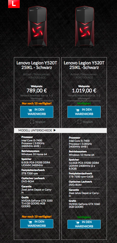

An example:
so here the difference in price is 3 things:
1 - amount of RAM (8Gb vs 16)
2 - Hard disk capacity/type (Rotating platter vs Hybrid Drive i assume)
3 - graphics card: 1050Ti vs 1060
processor is the same: i5-7400 ... so it's some kind of mid range processor ... looking at the benchmarks it looks like my old 2600k from 2011 is still a bit faster, so not so fast a processor at all but useable for sure.
1/ 8Gb of RAM is more than enough for the beginning
2/ you want an SSD as a startup disc so fi i would buy this one i'd get an SSD and use the included drive as a data disc anyways. The 7200rpm speed is good but tboth of these will be cheap OEM drives for sure
3/ the 1060 is only going to be marginally faster, the 1050 is more than enough for Fusion and it's the TI version which has 4GB of VRAM which is useful
so you could safely buy the cheaper one here, but personally i would try to find one with an i7 processor that ranks a bit higher, maybe an i7-6800K
just a random example to illustrate but maybe that helps a bit
