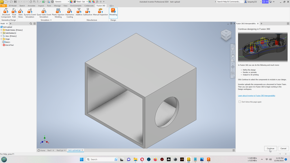

Best practices for transferring files from Fusion 360 to Autodesk Inventor also save back to the cloud as .ITP file.
The process is as follows:
  1. Access the Fusion 360 web view.
  2. Once you have located the desired folder, click on the download/export icon.
  3. From the options provided, select "Inventor 2021" as the format.
  4. The system will then guide you through saving the file in .IPT format.
  5. Autodesk file active for 7 days after compile file .IPT is sent to your email address.
  6. After the specified waiting period, you should receive an email containing the .IPT file as an attachment.
  7. Proceed to download the .IPT file from the email.
  8. Finally, you should be able to open the downloaded .IPT file using Autodesk Inventor.
  9. Save file to folder or create one to save your .IPT file
  10. Save file to the cloud as  .IPT file in your projects folder.
Fusion 360
What you will receive in a email
Autodesk Inventor
10. Save file to the cloud as  .IPT file.
