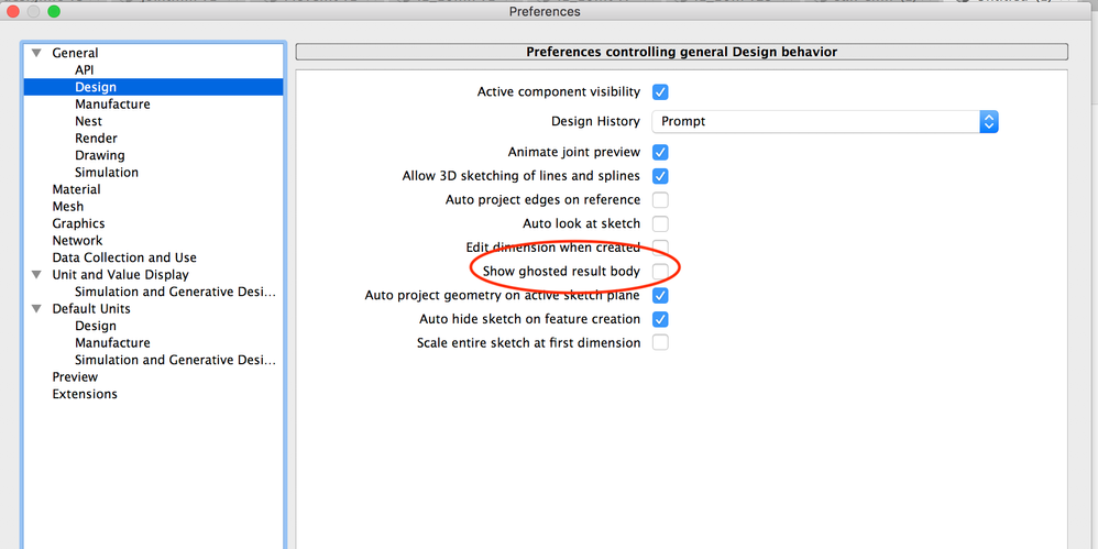

Hello friends,
I am facing a weird surface representation in sculpting mode. It looks like double surface or something, please see attached video. It occurs when I finish the form and then going back to re-edit the model by activating the sculpt mode again.
Did anyone had/has this issue? Is there any fix for this?

jeff_strater
You are seeing the "ghosted result body" - this is a dimmed view of the result BRep body made from the TSpline body.  The idea is to give you some reference to the result when you are making changes to the TSpline.  If you don't like it, you can shut it off here:

Thanks a lot, Jeff💪🏻👍🏻💪🏻
