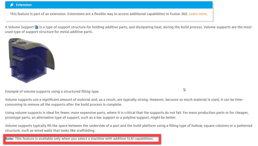

For some reason I'm missing a lot of supports options in the manufacture workspace.
Namely, I'm looking for the "Volume Support" option.
What am I missing?  It's for 3d Printing on my Prusa.
Thanks.

jimmberry
I'm looking to add volume supports to the print inside the manufacture workspace.  I'm not looking for the volume of the piece.
jhackney1972
Your Additive 3-D Printer must be capable of SLM (Select Laser Melting) to support Volume Support.

jimmberry
That explains it!  Bummer.
Thanks for your help.
