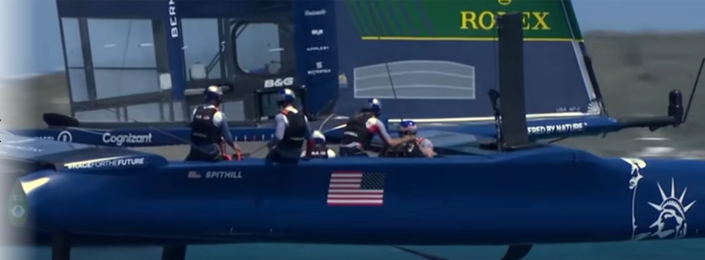

I have very little useful info about the aft beam and how it attaches to the hull etc. An old pic (2016?) which I didn't save showed a hull being fabricated, and it did not show any flat area for attaching the aft beam, unlike the forward beam.
It seems that they added a section that bolts on to the hull, as a flat area for connecting the beam to.
Most of the attached pics are from races in 2019. The beam looks flatter in 2021 where it attaches to the hull.  You can easily tell the difference as they also added an extension to the hull. Originally, the trailing edge of the beam lined up with the transom, now the hull extends further aft almost 0.5m.
Compounding the difficulty of creating this aft fairing is that I have a hull section there that is crap.  It sticks out topside where it shouldn't, a result of inexperience in "lofting" (drawing) the hull lines properly. So the outer edge of the beam had to be curved, whereas it's clearly not in the pics.
Hopefully, I will become more proficient as I gradually learn CAD techniques!
Message 9 of 9
MaxHugen
Forgot to include this pic... shows the general profile of the extra support piece between the beam and the hull. It's a recent pic but doesn't yet have the new transom extension to the hull.
