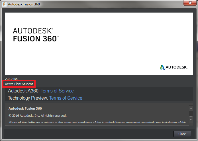

If you go to the help > About dialog in Fusion 360, what does the active plan field say?

@Anonymous Sorry for the confusion... I noticed in your previous screenshot that the save command appears to be active, which may indicate you have an active license.
If you go to the Help > About dialog, there is a field that reads active plan.
I'm curious if this field is there and reads what the active license is on your system. Could you share a screenshot of the About dialog?
