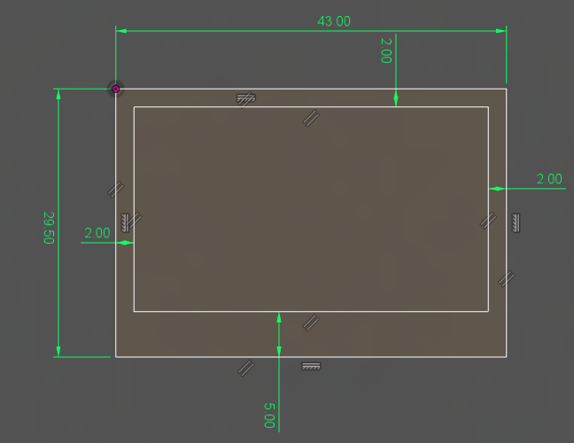

I have watched a number of tutorials and can never seem to get the same behaviour in F360! I'm new to CAD in general but the following seem to elude me and I would have thought simple functions:
  1. I can add dimensions in a sketch but once extruded I seem unable to change them again (for example I want to make the hole in the middle of this sketch smaller by 0.5mm all round (http://a360.co/2CrCAfM)

It's the way you did it that's making it not work like you wont it to.
A simple object like what you are making only needs a couple of sketches.
If you do the first sketch like the attached pick it makes it a lot easier to control the size of the object.
What is sketch the outside to the size you think you wont then do a offset sketch for the rectangle to the size you think you wont. If the inside sketch is to be an offset sketch from one side you just sketch a rectangle and diamention it in so it is where you think you wont it to be.
Dimensioned inside rectangle.
Then you just extrude it up to the height you think you wont.
 Then for the sketch for the side hole do it on the inside face.

Thanks, where I get stuck though is after I extrude (step 3) - if I know what to go back and change the size from 2.00mm to 2.50mm the dimensions are gone and if I try to re-add it just says they are over constrained. Am I missing an option to view dimensions?

I figured it out - the step I was missing was editing the sketch, I was clicking onto the face and expecting that to edit
