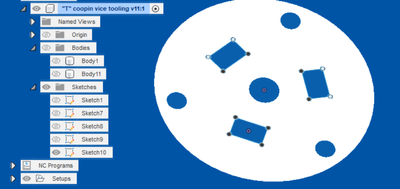

How can i turn off the model from highlighting when i mouse over it? If i have sketch dimensions on a model face but mouse over the model, and not the sketch dimension on the model, it turns white blocking any visibility of the sketch.
Not moused over:
Moused over:

Natranzow
When you turn off the model, the now invisible model faces still light up when moused over. I don't care that it does this. I care that it washes out literally everything in line with that face.

Natranzow
All bodies off. Only thing visible is the three rectangles around the center hole. Yet the model face still highlights when moused over.

Natranzow
Im NOT mousing over anything in the browser. This is ALL in the work space.
Here I have only the one sketch visible.

jhackney1972
Your Screencast shows your problem.  You have "Auto Project Geometry on Active Sketch Plane" in your Preferences turn on.  So when you created the small rectangle sketches, on the back face, the outside edge of the circle was projected and created a Profile.  You have "Show Projected Geometries", on your Sketch Palette, unchecked and have "Show Profile" checked so that is what you are seeing as you pass over the body area in the design workspace, the profile of the complete circle which seems to you is the body showing up.  My Screencast will try and explain it better.
