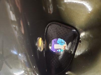

If you can, use this one for you latest update. This has less on the timeline and is simpler for me to follow. If not, ill go back and try to follow you again.  In the pictures, you can see the fitment from the front side of the bumper.  I need to extrude it down more  off the top of the funnel side. Fitment is a bit tighter than I want. From pipe up to the middle loft ( just under the tabs is perfect.

I added picture of the related bumper.

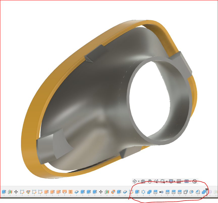

I tried to get the form correct. I found that the left/right loft further out than the top/bottom. When I go to thicken it to my 3mm, it wont let me. What is going on now?

Best I can figure it out, you have these new outlines in the front area of the duct.
Shell / Thicken will fail when each of these intersections are not Tangent connections, in this sketch.
I would also worry about this blue ring, (would not be needed in my loft.)
Might help.....

davebYYPCU
If I make the Loft tangent to the pipe, then the Thicken fails, but as a connected set of profiles, the inside Thicken works.
I used Sketch 13, but not sure if that is correct.
That sketch has so many individual curves, that not many are tangent connected.  A cleaner sketch will make Fusion happier.  Black edges in this pic, are from curves not tangent.
Might help.....
