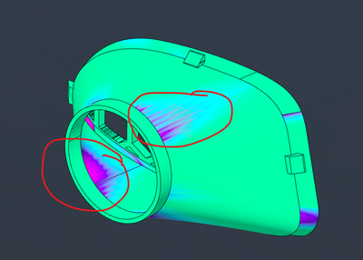

TrippyLighting
I have not looked through the timeline in detail yet, but for better geometry I would never create geometry directly from these mesh section sketches. I personally use those sketches as visual aids to create the curves using control point splines. That creates much cleaner curves, which results in vastly improved geometry. In a simple project like this that may not make any difference, but if more complex models, these surface artifacts can interfere with modeling.
Also, if modifications need to be made, mesh section curves cannot really be edited. Control point splines are very easy to edit.

TrippyLighting
The screenshots are what the Analysis->Curvature Map returns.
You'd have to re-create the geometry from scratch using control point splines.
