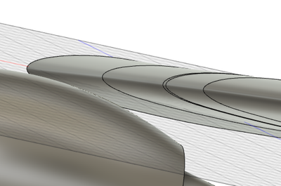

Hello. I'm creating an airplane wing for my personal project. I'm quite new to Fusion360 so I'm still trying to understand the features.
As of my current state, I designed an engine and an airplane wing. However, I'm having difficulties attaching the engine to the wing. Essentially, I'm unsure how to create the FWD wing/pylon attach point.
Would anyone know how I could connect my pieces together? I tried creating a hole and lofting the pieces together but that didn't seem to work. Here is my current state,

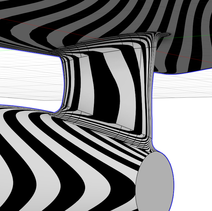

Here's one way. I'm using T-splines to build the pylon. Why? Because I can very quickly form an aerodynamic shape with very few control points giving very smooth curvature. Then once the pylon looks good, I blend it into the other bodies with a G2 fillet.
