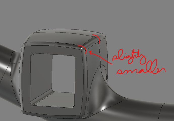

Please see attached screenshot.
Re-creating a 1920s front axle from drawings and for some reason F360 cannot produce a fillet around this bracket / cylinder intersection.
I was previously able to do it before I added guide curves to give the rectagular bracket it's proper curvature, 200mm radius; with the previous 2D curved faces I could fillet sucessfully.
Are there any workarounds available?
Without the 3D curves of the rectangular bracket the finish machined item just wont look as it should.
Workflow was to make a 1/4 of the axle, sweep the half cylinder and loft the rectangular sections from 2 planes with guide rails in 2 planes to get the right shape then mirrored the section to create one half.
Rads required from R10 to R30.

R10 and R30, bit vague in some respects but these things were originally forged and filed into shape. If a solution could be found to blend along the length of the chord to get 10 at one end and 30 the other, smoothly, that would be great.
As I said, when the rectangular shape had 2D faces, it worked.

primary issue here is the use of loft, which isn't really the right tool for the job.  loft can result in all sort of unintended surface quality issues when linking up multiple non-curvature continuous curves.
first of, the loft isn't tangent across the mirror boundary-
 which results n a near tangent condition at the edge to to be filleted that would cause any fillet to fail-
I THOUGHT changing the condition profile at the center line to directional would solve that.  but it didn't.  I don't understand why, that should be what the setting is for.
so..
dropping back to the old standby of using a helper body (horizon modeling in the new lingo) did improve that situation-
but there is still the problem at the bottom, again caused by the loft.  that's not ever going to fillet either.
I tried removing the fillets in the sketches, and then adding back in modeling space, but again there is something up with the surfaces that won't allow the fillet at the corners to be added back.
The answer of course is to not use loft here. (only use loft when nothing else will do.)
the squarish shape is really just a scaled sweep.  nice thing about using a sweep is you only need the one profile at the mirror line, one path rail, and one guide rail to control the scale.  all the above wonky goes away, and it's easier to execute-
this geometry allows the fillet your after.
I suppose you could take issue with the fillets at the corners of the original profile also scaling down as the profile sweeps forward.
if this bother you, you can
1-delete the fillets after the fact from the solid and apply sold fillets (will work with sweep version, didn't work with loft version)
or
2-remove the fillets from the sketch profiles, and add them in the solid environment. (again, works with sweep version, not with loft version.)
see attached model

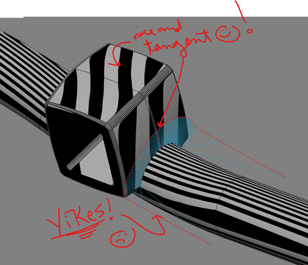

Cause I can't leave well enough alone, I'm revisiting this with an update.  I just had something pointed out to me in a different thread And i wanted to see if it effected this model.  low and behold...
so changing nothing but the settings in your loft so profile 1 is set to directional, and DELETING ALL THE RAILS, and making sure tangent rails stays checked (it was before, just sayin, that bits important)-
you now have a tangent condition across the mirror plane, and the edge where the fillet goes is MUCH better.  not as good as with the sweep, but good enough to accept a fillet-
so, the rails where screwing with you and messing the loft up.  If you need to control the curve of the sides more, then you can either add rail at either end of each fillet, or do the sweep function like I suggested before.  still, this is interesting.
with the fillets-

@beresfordromeo Don't worry about it, you espcially have gone way over and above the call of duty!
The thing that confused me about the rails not giving tangent geometry was that the arcs were drawn on centre with the centreline plane. I never realised things could diverge from that initial condition so easily.
In the end I went with changing the loft to a sweep and it's worked from there. I'm super impressed by your dirty tricks bit it's way above my abilities at the moment, I can't evwn begin to get my head around it. I thought I was reaosnable at this game but clearly still a beginner.
How does one do the black and white stripes thing?
Any way to join surfaces that meet at a perfect tangent or along a straight mirror line? No biggie but it would neaten up the look of the thing!
You can turn on a Zebra Analysis using  Inspect > Zebra Analysis
