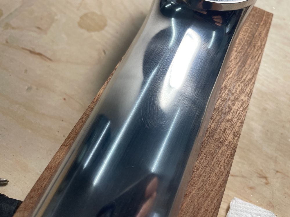

I wound up getting this part made, some issues with the file I'd like to adjust but can't seem to figure out how to go back in and change things.
In this picture you can see some strange ghosting or very subtle ridge in the part right at an area of patching. There is also a sort of sharp ridge going lengthwise, another area that had been stitched. I believe this was caused from not using the correct type of patch, and I should have used tangent, I'm having some difficulty going back in to do this, any advice on how to unstitch, change patch type and then re-stitch easily? My timeline is quite messy. I've unstitched the part but it will not allow new patching to be changed to tangent or curvature.
