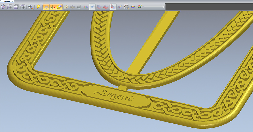

I have one STL file that Fusion just doesn't import correctly. Same file works fine with Inventor, Meshlab and ArtCAM. I tried to convert it from other programs to OBJ and other things, but it still has the same broken effect.
This is how it should look like:
And this is what Fusion thinks of it:
Also, the model size in Fusion is 10x bigger than it should be. Correct in all other programs.
Any ideas and/or suggestions?

The "broken" looking geometry is an artifact of the way the mesh is shaded. We are working on a fix. The geometry has been imported correctly. If you apply a matte material to the object, it may reduce the appearance of the artifact.
If you are inserting the mesh into Fusion, you should get a dialog asking you to define the input unit. The default unit is mm.
If you change that to cm, your scale problem may be solved. Please let me know if that works.
