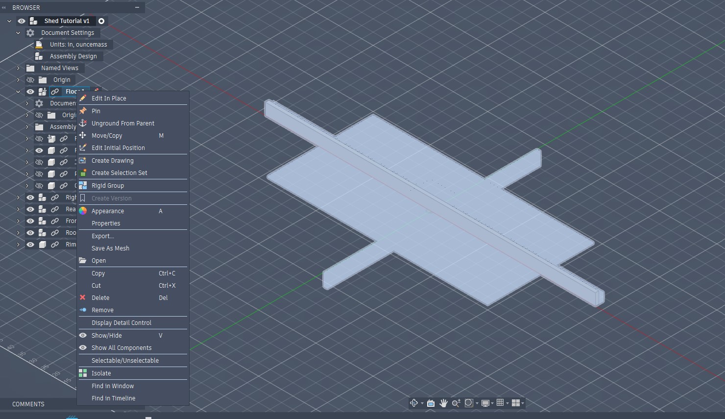

I am new to Fusion and creating more complex drawings. I have worked in AutoCAD a bit, but I have not had this issue come up.
I am following this Youtube Video on Fusion : Autodesk Fusion 360 - Part 1/4 - Model and Assemble a Shed - Intermediate/Advanced (2023) (https://www.youtube.com/watch?v=B8-NYBlOORY&t=956s)
I followed along well until time 14:20 when he copies a component then pastes it into the same subassembly. I can copy the component, but when I right-click the subassembly I don't have the option to paste. I do have the option to paste it into the top level assembly, though.
I believe it has something to do with me having to select "Edit in Place" vice just selecting components and subassemblys.

I tried having the Floor subassembly in "Edit In Place" It allows me to save Copy as, but not paste?

I am attempting to copy the component Rim Board in the Subassembly Floor, so I'll have Rim_Board_1 and Rim_Board_2
in the subassembly Floor. I am unsure what you mean about instance so same assembly.

@davebYYPCU I agree, I noticed that my file has linked items and edit in place. Where the tutorial does not. I do not know how to make my program not link them like that. If I just follow straight from the video, it formats it like this. Is there a setting that needs to be changed to make it to where it doesn't do that?
Message 11 of 16
davebYYPCU
One goes with the other, linked files, can not be changed, without Edit in Place in your current file.
Right click, on the browser items, you get the Break Link option.  If you do that you have consequences to consider.
I did not examine the video, to see if the files are imported in the tutorial.  There is a possibility but didn’t check for it at the time.
The patterning of Floor joist was done in the tutorial main file.
You are a victim of new upgrades?  In 2023, we did not have this new interface and wonderful Design with Intent interference.  I think you were lost in making / saving Part (default) Files.  Autodesk has utterly destroyed the tutorial workflow recently (January 2026)
build in place files, (Hybrid these days) do not have linked components.  Copt / Paste Components is a build in place workflow.
Might help….

@obulesub  It appears the video is from a different version. In the video the new components the author is creating does not automatically make them linked.
With the updates we have, we have to use edit in place to copy and paste components in subassemblies.

...With the updates we have, we have to use edit in place to copy and paste components in subassemblies.
Nope,
you should use Hybrid files, the video will then be the same as Fusion Hybrid file. You will not be confused by that video if you do this.
Autodesk is not promoting Hybrid, and has it hidden from default (Part) files.
