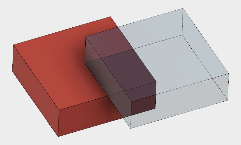

@jsmPGF5C, Can you provide some more details?  I tried a very simple case:  Two blocks, one transparent (glass), and one with a red glossy paint applied, with the top faces coincident.  It seems to me that the results are correct:
Can you attach your model here, and maybe provide some screen shots of what you are seeing?

I also can't produce the problem described.
Two components with coplaner faces...
