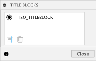

Ok I might be missing something. I have created new title block in one drawing.. Now when I try to create new drawing the title block is not shown on the list.. There is only default title block listed. How can I create new title block so I can use it in all drawing and possibly load as default.
Here is how I created new title block
Right click on Sheet Setting -> Title block

Here is what is shown in existing drawing
But when open new drawing I've got only default title

In order to save an individual title block, you must include it in a custom template.
However, this is only possible if you do not use a personal licence.

OMG.. I was afraid of that.. Thanks for your answer anyway... Looks like I will have to edit each one until I buy license 😞
