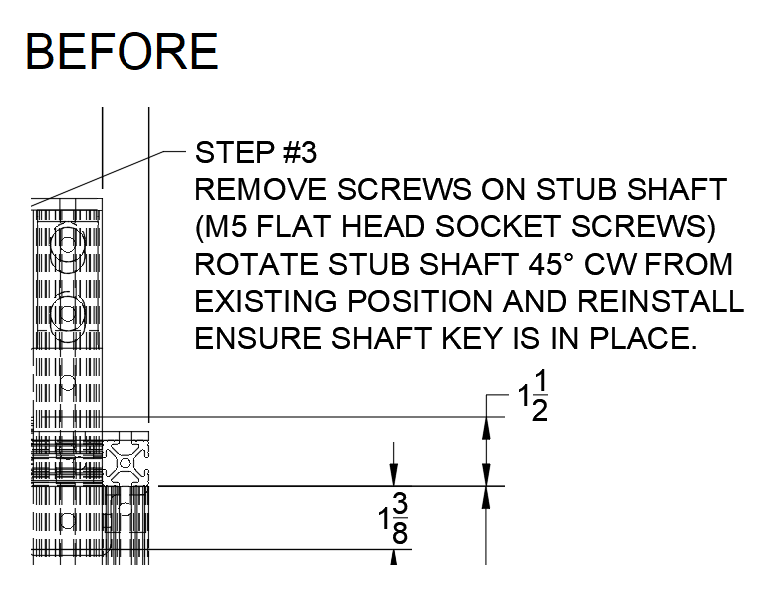

I stumbled across this fun little workaround that lets you create colored text inside of a Fusion 360 drawing.
If you copy text from another program (AutoCAD in my case) and paste it inside of the text editor in Fusion it will now be in that same color.
If you don't have AutoCAD you can also use Microsoft paint, just use the text command in there and paste your text in, then change the color.
All your modified text will know paste in the different color. VERY useful when doing drawing markups or identifying revisions.
A bit of a pain but it will help until a proper feature is implemented.
