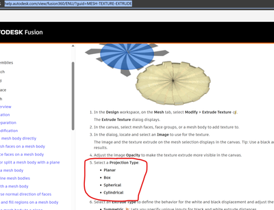

Hello, did the projection controls get removed from the texture extrude feature in the direct edit mesh environment? the projection type used to be listed directly below the opacity in the pop up window, but now I am not seeing it. Right now this only allows you to project planar, and something like a cylinder would benefit from the other types previously listed.

hello! No I have not yet found a solution to this, I have also verified with this education license, a hobbiest license, and pro license, none show the options I mentioned any more.

The online help is wrong https://help.autodesk.com/view/fusion360/ENU/?guid=MESH-TEXTURE-EXTRUDE
We did not release those projection type options in Fusion.
we hope to do that in the future.
