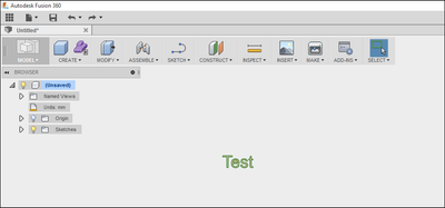

Frustrating!  I reported this (I think) about a year ago, and no fix!
  1. Create a Sketch
  2. Sketch some text  (example is in Arial at 10mm height)
  3. Close Sketch
  4. Zoom out so that the text is small on the screen
  5. Box select the text
  6. Hit Delete
  7. Zoom in
  8. See that not all segments were actually selected, and some are still there!
  9. The box select should have selected all segments within the selection area!
  10. This process works if you are zoomed in, but not when zoomed out...if I drag seelct, I want all to be selected, not remnants behind, no mater what the zoom level!
Zoomed out:
Text selected:
Zoomed back in:
Hit delete, and see remnants:
