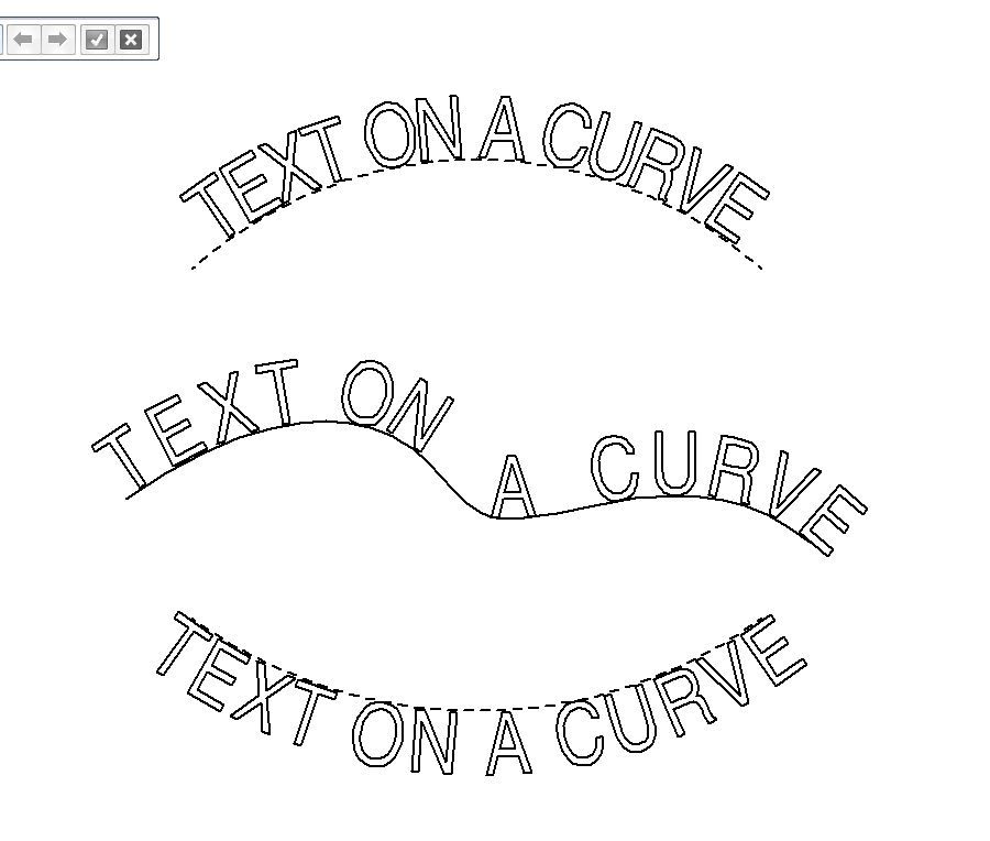

Thank you @davebYYPCU  but I am looking for something like on the attached image.TEXT ON A CURVE.JPG

etfrench
It's not hard to put text on a curve or spline if you don't mind a few SplineText.JPG
extra objects left over Smiley Happy  If I had used a different sketch than the one used to create a body to use in the Pattern on Path, then there would only be the text showing.
